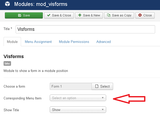

In Visforms 3.10.0 we have added an new option to the module configuration which can help you solve such a problem. Create a menu item of type Visforms >> form for the form which you publish with the module of type Visforms. The menu item must be published but it can be part of a so called hidden menu, that is a menu, which is not linked to menu module and therefore not published on your website. Then go back to the module configuration of the module of type Visforms. Select the menu item of this menu in the select "Corrresponding Menu Item".
